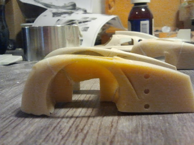

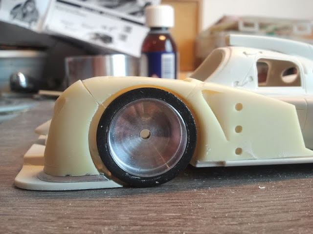

To start with, the Toyota TS030 that I want to build, has front wheels arches having room for 30,5mm wheels. As in the races where I race 26,5 is the rule and standard, I decided to modify the model. In total I chopped and cut each wheelarch 8 times.
I also had to raise the rear deck a little bit to provide room for our motors, and widen the rear arches inwords a little bit so that our spurgears can fit. Here are some pictures...

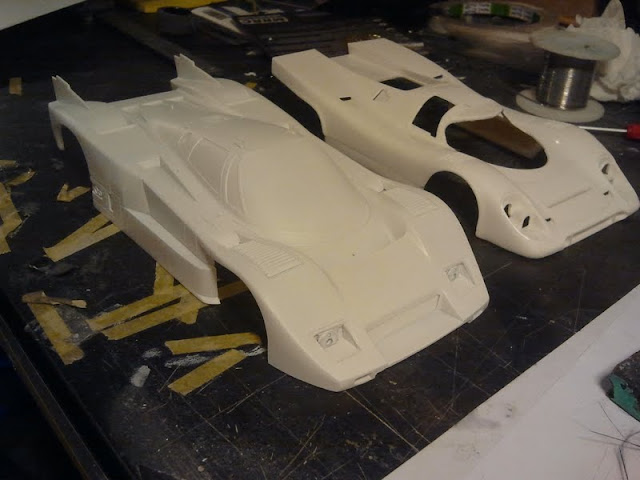

I also did a Lancia LC2, based of the old Tamtech body, and built in the light units..
After laminating, they look like this. Around 15-17 grams and very durable indeed.

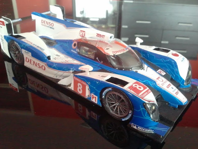

Sooooo
Der erste is fertig. Alle flaps sind heile und komplett dran. Mann war das mal wieder ein projekt. Viiiieeeell zeit, leibe und geduld habe ich in diesen modell gesteckt, und ich freue mich schon auf die nächste tage dann auch unsere renndeckel auf zu bauen furs rennen in Spanien, das ist ja schon in 2 wochen..
