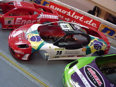

F430 Rules
Pictures F430
Is this O.K.?
Checa

posted on 18-6-2008 at 00:14 Reply With Quote
Sorry, I don't know how insert pictures in this forum

posted on 18-6-2008 at 16:21 Reply With Quote
The most active photo publisher is certainly Fola :holy . Check out his F430 album at http://picasaweb.google.de/fola.osu/430
Checa you can upload picture (not larger than 800x600) via Attachment or link to it using the HTML code "open angle bracket (less than sign)img src="--URL to your picture--" /"close angle bracket (greater than sign)
[EDIT] apologies for the confusion - should have asked Fola first and not post incorrect information :comp1: - and thanks Fola for the very nice and detailed pictures you've posted below :holy [/EDIT]

posted on 18-6-2008 at 16:52 Reply With Quote
I thought the rulebook said the WHOLE wheelarch must be present??
:upset:
Well, whatever, I'm glad this will be my last Int event for sure.. Impossible to keep up with Fola's work..
Looking forward to Spa 24 hours.. :car:

posted on 18-6-2008 at 22:39 Reply With Quote
2º time to insert pictures
Checa has attached this image:
reducida 1.JPG - 352.7kb
Checa
Posts: 27
Registered: 7-2-2008
Mood: No Mood
posted on 18-6-2008 at 22:46 Reply With Quote
The pic I show you is with other reference of F430.
My question: Is allowed the hole in the wheel fender?, like Fola.
Posts: 338
posted on 19-6-2008 at 06:00 Reply With Quote
guys dont PANIC.
the cars i am building for the worlds do not have that hole.
The pictured cockpits were built for normal test cars to see
how things fit.
Please ask me for my concent before posting my pictures anywhere.
fola.
