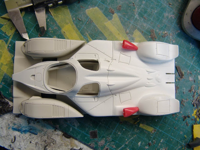

I my new resin 2006 908 just arrived, and now I can finally start with the Pescarolo project.
The 908 needs to be butchered a bit so that it really resembles the LM2009 version as Raced by the Pescarolo team with the #17 at Lemans last month.
First step - Rear fenders and air intakes. The fenders need to be shortened and of course widened so that both the wheel and spur gear can be accommodated......
will let the pics do the talking as they can tell the story better;-)

a smallt update....
and a list of modifications.
1. The front lights have a new shape this year.
2. St27 made the front louvres wrong, they extend way to far towards the ft. lights
3. the front lip is way too low and causes guide movement problems. I added 1mm tro the height and now it works looks correctly too.
4. Closed up the Position light holes.
5. built new airpods on the rear fenders
6. remodelled the area underneath the airpods.
7. Widend the rear fenders to make it slottable..
8. Shortened the rear fenders as per the 2008/9 version
9. made recesses for the airpods
10. Joined the rear light holder (?) to the body and closed the seam.
11. Added rear Naca ducts
12. Added postion lights to the rear.
what next??
as always...pics say it better ;-)

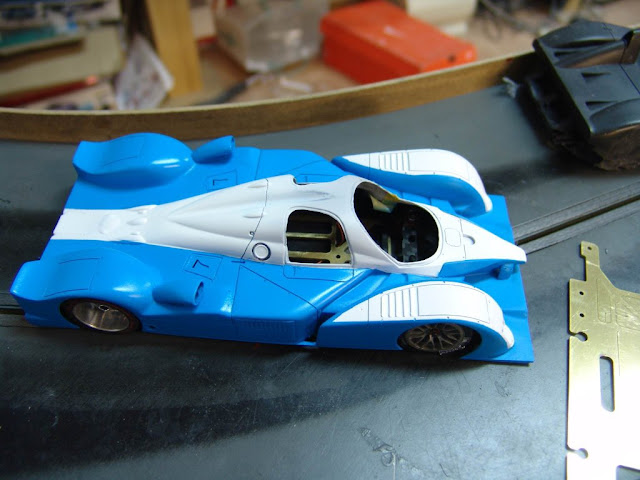

and now another update!
FInished work on the Master and laminated a Carbon body and the result was just fine.
The nose was partially missing but an easy fix.
Clean up and then Primer, white paint, blue paint decals........
http://lh6.ggpht.com/_PvLDsC2pRvk/SnNbPDsGGNI/AAAAAAAAKu0/b6M01Y9p9UU/s640/DSC02194.jpg
http://lh4.ggpht.com/_PvLDsC2pRvk/SnW_ZKq26hI/AAAAAAAALck/V4mpd-lLo6g/s640/DSC02239.jpg
http://lh3.ggpht.com/_PvLDsC2pRvk/SnW_taqUHzI/AAAAAAAALdQ/xKs1rHOC-iQ/s640/DSC02264.jpg
http://lh3.ggpht.com/_PvLDsC2pRvk/SnXAEhFjMQI/AAAAAAAALds/m89NaAz91_A/s640/DSC02271.jpg
http://lh5.ggpht.com/_PvLDsC2pRvk/SnXATi1NKYI/AAAAAAAALeI/B1A2qh6gd-s/s640/DSC02278.jpg
http://lh5.ggpht.com/_PvLDsC2pRvk/SnW7ZWa60WI/AAAAAAAALx8/QWLaknp9UgY/s640/DSC02287.jpg
http://lh6.ggpht.com/_PvLDsC2pRvk/SndzdwufwrI/AAAAAAAAL2Y/g2d0C7cgYx4/s640/DSC02303.JPG
http://lh5.ggpht.com/_PvLDsC2pRvk/SndztjEDYbI/AAAAAAAAL2s/90z7ivgUtz8/s640/DSC02307.JPG
http://lh4.ggpht.com/_PvLDsC2pRvk/Sndzue7HQzI/AAAAAAAAL2w/BlR5RaHSak8/s640/DSC02308.JPG
http://lh3.ggpht.com/_PvLDsC2pRvk/Sndz1u4BdaI/AAAAAAAAL3I/4qlYo7b5PpQ/s640/DSC02314.JPG
http://lh5.ggpht.com/_PvLDsC2pRvk/Sndz4ffk7NI/AAAAAAAAL3Y/X4RAr2RXAAM/s640/DSC02318.JPG

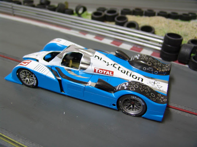

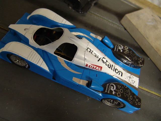

U P D A T E ! !
Made a spoiler out of plastic sheet.... Added carbon decals and the sponsor decals, and
made Spoiler supports out of rubber (They are not yet fixed, glued or in place !)
http://lh3.ggpht.com/_PvLDsC2pRvk/Sny4kK9GOaI/AAAAAAAAMUo/t_M85sz3VhM/s640/DSC02349.JPG
http://lh3.ggpht.com/_PvLDsC2pRvk/Sny4lqGg_RI/AAAAAAAAMU0/KYM8oGZr9dc/s640/DSC02352.JPG
http://lh6.ggpht.com/_PvLDsC2pRvk/Sny4mmDPkHI/AAAAAAAAMU8/In16GSf6BDo/s640/DSC02354.JPG
