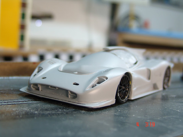

Hi Guys,
been away for a while, but still very busy and active.
here are the latest developments regarding the car we will race at the NURBURGRING race
on Swisttals SPA track in Germany.
The "Old" kit I had was "nice" but a bit round and a tad too high.....
the 2011/12 version is a lot sleeker, and the nose is totally different plus. it has the fin in the roof.
meaning a lot of sanding, cutting, filling work needed to be done to get to
the new slim streamlined shape that the 2012 version has.
Started by marking the areas in need of attention, on a slush copy of the current version.
Chopped the roof and channelled the sides in order to bring the car down about 7mm
a feat only for the brave as you can see in the pics....
https://lh4.googleusercontent.com/-Q2kvnan70z8/UNzsuRRqmTI/AAAAAAAATUw/xzyqlJr-uuU/s512/DSC09489.JPG
https://lh4.googleusercontent.com/-9FjdHcxzOYc/UNzsvXpa4dI/AAAAAAAATU0/ngOgpGJ_51E/s512/DSC09490.JPG
https://lh4.googleusercontent.com/-btIak2JyZaU/UN2CP_EDxRI/AAAAAAAATW0/kyBfEfyP6qs/s512/DSC09507.JPG
With the body "dropped", it was time to remodel the front areas .- Nose air intakes
on the bonnet and on the widened front fenders
https://lh4.googleusercontent.com/-3p-MziOXKwU/UN4ycHidUiI/AAAAAAAATZE/hmH57JRVJvw/s512/DSC09522.JPG
https://lh4.googleusercontent.com/-QD2z-oy4Lf4/UOHAVmzMsaI/AAAAAAAATbI/de-D2qZDQbM/s512/DSC09536.JPG
https://lh4.googleusercontent.com/-FUR3N03dlG0/UOL_hd70wsI/AAAAAAAATlw/0qrrzHhFzKQ/s512/DSC09551.JPG
Grafted the air vents on to the widened front fenders...
https://lh5.googleusercontent.com/-ZOPUocs5FAs/UORrO2616sI/AAAAAAAATo0/6yJpVzTTLt4/s512/DSC09566.JPG
and reshaped the front air vent....
https://lh5.googleusercontent.com/-2ZBHSa86MuE/UORrVJWAUvI/AAAAAAAATps/TNlMrCDyoak/s512/DSC09573.JPG
and created the roof air scoop out of hardened body filler.... and the fin with plastic sheet.
https://lh6.googleusercontent.com/-i5BlczK5tdA/UORrPuP3OeI/AAAAAAAATo8/gMn9DRIBqaw/s512/DSC09567.JPG
https://lh4.googleusercontent.com/-ypIZDRKMuHw/UORrX1GIo1I/AAAAAAAATqA/nyJrp1JPkIc/s512/DSC09576.JPG
https://lh3.googleusercontent.com/-h-DP0oPlhKQ/UORrbKzuztI/AAAAAAAATqg/SlHYQE_XKwM/s512/DSC09580.JPG
https://lh5.googleusercontent.com/-j3nqcPmpFww/UOTTonZ2nOI/AAAAAAAATsE/fjJV5-1zbMs/s512/DSC09587.JPG
https://lh4.googleusercontent.com/-gUjhMrOLAUE/UOTTnGyTpgI/AAAAAAAATr8/Rq8jksc7b3Q/s512/DSC09586.JPG
The rear needs some reworking, hood pins final finishing then I can get on with
laminating and building the actual car.....
will keep you posted ;-)
